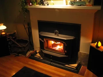

Hi,
Have had this stove since late September, I noticed over the winter (maybe 7 or 8 times) a few bangs during operation. This happens after the stove has been operation for a few hours. it has been a sort of metallic bong, or ping, like the metal is expanding or popping, not too loud but a little startling. I’m using dry wood, and have not left the door open.
About two weeks ago I was loading it, after it had been going for a few hours and…BANG!!! A different sound, like a shot. Scared the *#$% out of me.
Then last night, I was sitting in my living room, chatting on the phone, fire going for about an hour, starting to die down a little, draft at 3/4, fan going...and BANG! Like a gunshot! Loudest one yet. Dog bolted out of the room! I jumped! Person I was on the phone with screamed!....it was LOUD. It was louder than a backfire, not metallic, just a big bang. This was followed about 20 minutes later by the bong metallic noise...and again 15 mins after that…
I’ve called the place I bought it from, they have never heard of this, but are “checking on it” and will get back to me.
Anyone ever hear of this? Any thoughts? I’d love to have some similar stories, or ideas of what it could be for when they get back to me. As it is now, I don’t want to use the stove again ‘til this is resolved.

Not usual for sure. Were it mine I would pull the shroud and see if something is falling out of the chimney and landing on top of the insert. Second I would pull the bricks and baffle and inspect the welds with a flashlight from inside the stove.
ditto, brother bart. I'd want a look at the welds after ruling out falling objects. I've broken welds on larger steel sculptures and it's loud.
After cooling off cracks could be difficult to see. Wire brush weld seems and use bright light with slow methodical visual inspection. Mist weld seems with sprayer and slowly dry with heat gun , propane torch, and watch water being pulled from steel,,it will leave the crack last leaving a darker color on either side of crack. If a dry inspection reveals nothing, try the water,,but dont heat it anymore than whats necessary to dry the area you are currently looking at. If still nothing wait till everything cools off completely, and inspect again,,,for water could till seep from the crack once cooled, the discoloration will be subtle.
Thanks guys, I'll get the company that I bought it from to have a look. If it was welds breaking, What could have caused it? Should this be under warrenty? I only bought the stove in September.
Forms of stress, mechanical and thermal are introduced during the welding process. There most likely are developed welding sequences, followed by different manufacturers with assembly, but these wouldnt account for things like running out of gas or wire at inconvenient times, or the new employees skill level.Some manufacturers may have stress relief operations which counter these inherient problems. Years ago after casting bells they use to drag them through the streets tied to a horse for stress relief. Horse must have been tired when the made the liberty bell.

On a completely unrelated note, from your picture of the Insert, is your house insurance for a wood burning appliance ok with your lack of hearthstone? Just saying because I had to replace my hearthstone with a larger one, (albeit 2" deeper) simply because my house insurance policy changed for no reason.
