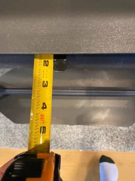

My bypass is sometimes hard to close and I noticed the rod looks a little bent inside the stove. Also, I don't seem to get temperatures as hot as others have mentioned and I suspect the Cat isn't fully engaged. My operating temps on completely open air control Range between (500F - 800F) when fully loaded. I burn hardwood with MC less than 20% (avg 12%).
Anyways, can someone measure and post the length of the bypass rod is when it is in the closed position, please? The measurement I obtained was 2.25" (see photo for details).

I get 2 1/8 standout when it's full closed.
With perfect wood on a very cold (read: high draft) day I can touch 1400 with bypass closed and air wide open, 975-1100 is more typical. Contrary to the pure cat stove folks, cruising on this hybrid seems to be when the cat pobe is 725-900 range (I'm typically running at 50% air unless I'm out of the house or its a very warm day)
At least that's what I've noticed after a season with it, YMMV.
