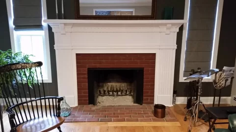

HisTreeNut, I'm looking for an insert as well. I really like the i3100 but wifey has vetoed it as she wants a flush mount. Ugh. The owner of the shop I have seen this in action at has the 3100 unit in his home. He can have any unit, which says volumes to me.Feeling the amount of heat this thing pushes out in person sold me. Sincerely, At Stalemate In Bethany.

HisTreeNut, I'm looking for an insert as well. I really like the i3100 but wifey has vetoed it as she wants a flush mount. Ugh. The owner of the shop I have seen this in action at has this unit in his home. He can have any unit, which says volumes to me.Feeling the amount of heat this thing pushes out in person sold me. Sincerely, At Stalemate In Bethany.
One aspect to consider is that the flush mounted units won't pump out nearly as much heat as less surface area is exposed. This is especially true if your blower isn't on (e.g. In a power outage).

I have a flush insert Jotul c350. It looks awesome, but I have to run it very hard to get much heat.
Next step for me a block off plate, but I think a non-flush stove would have much more radiant heat.
I said this on another thread, but after insulating the walls of my fireplace and filling in the damper opening the radiant heat has greatly improved from my stove. My 3100 sticks out about 5 inches and a lot of the heat comes off the glass, can't say for sure how much really radiates off the rest of the unit.
RSNovi, after you install a block off plate, I think you will see a big improvement in heat output.
I like the looks of the Regency and personally so not care for the flush mounted stoves. The biggest hang-up right now is the expense. It is an investment and money is tight. That is more of her worry...and given the economy and such...I cannot say I blame her.
