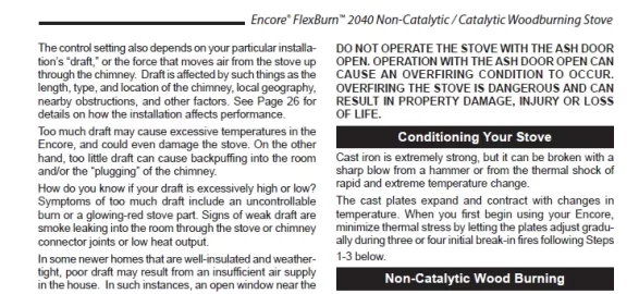

You do know opening the ash pan is a bad idea right?

why is it any worse than cracking the door?
Because it puts air under the fire causeing much faster heatup and more intense temps. This can lead to huge temperature differentials throughout tge stove which leads to warping and cracking. Almost all stove manufacturers say specifically not to do it while many say cracking the door at startup is fine.

thanks, i knew it wasn't a good idea to leave it open for long periods of time, but I only leave it open enough to get a small flame.... this is from my manual, which i read i swear.

thank you for the reminder, and I will change my practice!

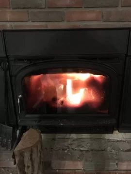

So listen to this ! I’m really new to the wood insert community (about a month in ) and from start I have had issues that this group has helped me with and I am so thankful ! So today I’m cutting my seasoned wood I bought but it was seasoned enough to burn . Again it was at the beginning and just bought wood . Butttt then I totally forgot that I have two pallet sheds that are back by my fire pit that are stocked with good seasoned wood ! Haha it was like finding money in a coat you wore last year ! I grabbed a few and put in the burner and BOOM that baby is cooking ! Lol im so happy right now that I just might drink all night in front of our FIRST awesome fire !

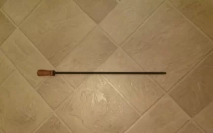

I rake the coals together, place some smaller splits on the coals and use this.
I made this from a piece oh 1/8" pipe, heated the end in my forge and tapered it down on my anvil tell the hole was about the size of an 8 penny nail. Turned a piece of hedge for a mouth piece.
Blow on the coals and away you go.
