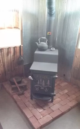

Here is my setup when it is to cold to work outside on the my forge.
--Love that Fisher. There have been times we have wished we'd kept the old Fisher. Those things were "tanks" & burning simplicity.
