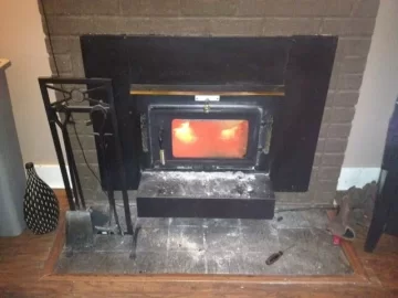

So I need some assistance understanding where to go from here. I tried removing the surround to see what kind of space I am working with behind it, but I believe the insert itself has to come out from inside the wall because the screws I believe are put in behind the stove. <> But how do I slide it out with the liner attached? It looks the stove itself is sitting on a layer of bricks that stick out on either side of the fireplace floor, which elevates it off the floor about 3 inches.
I attached a couple pictures to give you a general sense of what it looks like. Excuse the mess it is right now.
I'm sure I haven't provided enough information, but I don't know what to tell you. So can anyone help steer me in the right direction? I will probably be asking for help deciding on a stove too, but first I need to see what dimensions I have I assume?

I'm not familiar with that stove, how big is it? When it works right does it give you enough heat? You wanna go freestanding in the space or another insert?

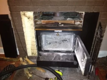

Just give it a tug. There should be enough play in that liner to get the unit out a few inches. The installer likely hooked up the liner, installed the panels and then slid the unit back the last few inches.
Thanks webby, I was wondering if I could tug it and do that, but was afraid to try. Once it cools down I'll give that a shot later today and report back the dimensions hopefully!

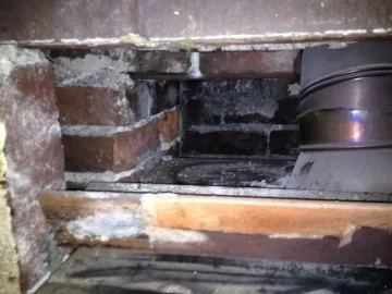

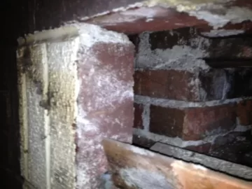

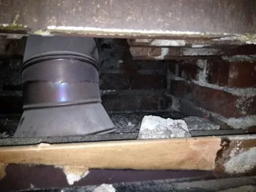

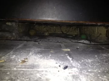

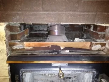

So the "give it a tug" method worked, and I was able to see the bolts behind the surround and take it off. Now that I see the interior, I would say that an insert would be best sadly. :( Its not very pretty inside, haha, and it looks like they built an additional brick surround outside the original fireplace interior, so I think an insert would be best to "cover it all up".
That being said, here are the dimensions of the existing stove: 20" Depth x 22" Height x 25 1/2" Wide
I would say that max dimensions of the interior are: 23-24" Depth x 29"-ish Height removing bottom bricks x 25 1/2" Wide
It has a six inch flue.
The existing insert is sitting on bricks that jut out at the bottom, so it keeps it up off the floor by about 3 inches. I can say with certainty its a full masonry chimney and fireplace now as well.
So with all that being said, if I wanted an insert that could work in this space and was under $1000, what do you think my options are? I don't have an extremely large house, I'm eating probably about 1,000 sq ft., but is is non-insulated and the insert I had now would barely keep up once it gets to the twenties and below, though it could manage keeping it at 70 if I constantly worked at it.
Also, like I said, I would want a non-cat. Any suggestions? Thanks in advance for your help!
I posted some pictures in case any are relevant.

Wow, it looks like someone cut out the original lintel. I guess if it was a problem, you would know by now.
It sounds like you will have enough room there for most inserts, but your $1000 budget will make it hard.
Webby, I don't know anything at all about wood stove installs or fireplaces in general, but it certainly did look like crap to me in there. :) What is a lintel that you mentioned they cut out?
What would a more realistic price range be? I am going to be paying it off through this year, so if its more I'll just pay more off through the year, I just picked $1000 off the top of my head.
The lintel is the piece of angle iron that holds up the brick. On the original fireplace face, it been cut out so the liner can come through.
You might be able to get a decent used insert in that range, but most nice new ones start closer to 2K.

If it all structurally sound (maybe a friend/mason can confirm?) you can possibly line the firebox with thin layer of Roxul and then use thin sheet metal to cover the mess. Someone here did it and looked pretty good, form will be second place to function!
