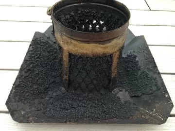

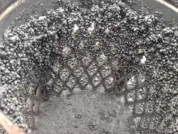

Here is my chimney cap at end of last winter. Not too hard to brush clean and I got about 1/2 gallon of creosote from sweeping the liner.
I'm kinda new to this so I don't have a gauge on if this looks bad or normal.
I'm excited to see how much less creosote I get at the end of this burn season.

Am I looking at this wrong, or is most of that expanded metal fully clogged? That crazy!!
Yeah, you should do better than that for sure. Looks like your wood wasn't fully dry, and may have been snuffing the cat. If the cat is burning well there shouldn't be that much gunk getting by it. Hopefully, it's not plugged with creosote or ashed up, or it may need to be removed and brushed, or simmered out with the white vinegar/distilled water bath. I would check it before you have to fire up the stove this fall.
I have an external masonry chimney with insulated liner and got 1-1.5 qt. after a full season. Had some flaky stuff in the top of the pipe and on the screen, but only powder further down. Keep checking, and brush way before it gets that plugged. If your wood is much drier this year, you may well be able to go all season without brushing.

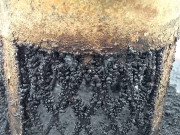

I have the same cap and my barely looked like I had been burning last winter (as in it still looked damn near new). To be fair, I was only burning on nights and weekends. However, regardless of how much you were burning, that looks like a complete mess, to be perfectly blunt. How seasoned was your wood?
