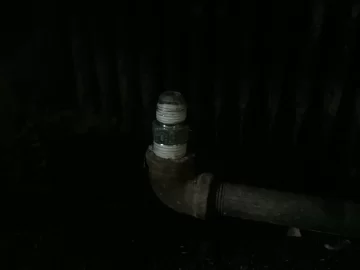

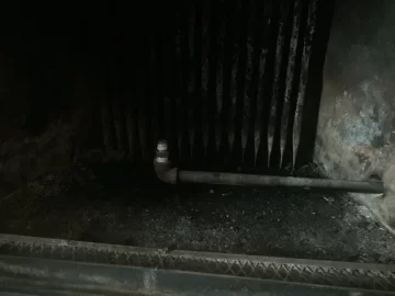

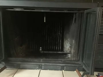

Hello everyone, I'm new to the forum and also new to ever having a fireplace so I've got a couple of questions if anyone can help. I've attached some photos of my empty fireplace just as it was when we moved in. It obviously is a gas fireplace, or at least intended to be but I can't find out what needs to connect at the end of that gas pipe, if anything at all. I'd like to use the fireplace as a real wood burning fireplace without any crazy modifications. A grate cannot sit there because that pipe is 5+ inches above the bottom which interferes. The landlord says the fireplace flue and chimney should be safe to use, and upon my inspections looking up with flashlight, I'd say it's ok. Now, my question is, can I just use a pipe wrench and turn the gas pipe upside down or towards the back so that my grate can fit there and just use it as a wood natural fireplace? If not, what can I do or what do I need to buy? I look foward to your replies. Thank you!

You need to have a professional sweep or installer check that chimney out and get rid of the pipe all the way. Is it hooked up to a natural gas or propane line? If so I wouldn't even try it
It's hooked up to the natural gas line, with the key at front to turn on and regulate gas. I'll get a sweep to come tomorrow hopefully to inspect, but hoping to use fire for Dec 25th. I can't modify too much though being a rental home.
are you planning on calling a sweep tomorrow and hope to have fire by the 25th or did you scedule an inspection already? if you are calling tomorrow good luck with that
Glad your having it looked at but getting a gas line hot :rolleyes: You might get hotter than you want
I think it would be a bad idea to use this before having it inspected and approved for wood burning. All kinds of bad things might happen on your Christmas Day.

What I'm confused on I guess is, if it's still a gas assisted fireplace, that gas pipe would get hot anyways so in my mind it seems it's made to get hot. Or is it meant to be one of those fake log looking things? I've also heard of the fireplaces that only use the gas to get the wood fire started, then you turn gas off and let the wood continue burning, in that same case, that pipe would get very very hot too.
that is absolutly not a log lighter it is also a weird location for a log set to though not sure what it is. That is why you need to have it looked at
Alright, well I'll just hope to get a pro sweep soon and see what he/she says. Or, I'll call my brother-in-law who is a certified HVAC technician to see if we can easily remove that pipe but still allow it to go back in after I move out. Who knows, it might just easily unscrew. Thanks for all the help everyone.
