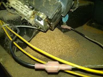

there is another site that I link on my site that has both the bushing for $10 and the upgraded Nylon kit $49
the nylon kit is an upgrade because it holds up better that the brass bushing and lets less sawdust fall through into the bottom of the stove.

Hearthtools, thats a good picture of the sawdust. I've been getting more dust underneath the auger and just didn't understand where it was coming from, I'll keep a closer look at the auger motor gear box area. I spent a interesting saturday fixing one of my own screwups but learned the basics of the wiring on the old WH-II. A local small appliance repair shop had a Hi liimit switch in stock for $9 vs $40 from the approved Lennox Pellet Stove Shop (they would have to order it). As it turned out I didn't even need the switch, but I got a spare now. The more I work on the stove the more I appreciate it being DIYer friendly. bjr23
