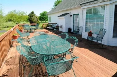

Looking at a potential home to purchase down here in SW Ohio (moving from NEOhio) - great house, but has a direct vent gas stove with no real chimney.
I've attached a pic of the back of the house. Is it possible to remove gas stove and run pipe through the bump out? Seems it would have to be a long run of pipe if it has to be above highest point of roof (I know I've seen a diagram that details this situation in a Duravent catalogue). Would it be better build out the hearth and run the bulk of the stove pipe length on the interior of the home? The ceiling in this room in the house is vaulted.

Does the gas stove currently work? I think if I were looking at that house, I would possibly leave the gas stove alone and look for another location in the home to install a wood stove. I have a gas fireplace in one side of my home which was installed to offset the high cost of running the oil furnace. The wood stove was later installed in another room which gets run to offset the cost of propane since most if not all my wood I cut for free if that makes sense. The nice thing is if I'm not home for some reason to load and burn the wood stove, my wife can still fire up the gas fireplace or oil furnace and have heat since she doesn't really deal with the firewood situation. I like to have backup in place just in case. I guess my thought would be you could leave the current gas stove alone and install your stove elsewhere in the home if it's possible. Just an idea
Good advice. If the stove is a decent one and a good heater it might be a good idea to keep it.
Beautiful deck!
Yeah if there is a good DV gas stove in there I would leave it where it is. Doing what you ask about depends on a whole lot of things with what is in that bump out and what hearth is in the place.
If it works, and it's safe to operate...why get rid of it? If you really want a woodburner, you can put one somewhere else. In some ways, this will be easier & cheaper, and you'll have another back-up. Tell us all about the house, post a simple floor plan, and we'll be all over it like flies on poop with great ideas. Rick

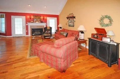

I thought about alternate locations, but the house is centered around family room/great room which has vaulted ceiling. I think it would look silly to have a stove and fireplace in same room and it would also take up too much real estate. Pic attached. You can see how this location screams Hearthstone (at least it does to me). I had a dv gas fireplace before and didn't miss it. House after that one I installed a PE insert and Napolean 1150P and refuse to look back. Wood heat all the way!!!! I also like the location at the back of the house for access to firewood supply.

That is going to take a lot of pipe. You don't have to necessarily be above the peak, but you have to comply with the 10-3-2 rule. Which is still going to take a lot of pipe.

I agree with the other posters here. Where your gas fireplace is is not the ideal place for a wood stove. Better to situate the stove where the chimney can go straight up and exit the roof close to the peak. This will reduce the cost of your chimney and make the installation much more simple and practical, and perhaps make it easier to clean the chimney later.
The room looks nice and open, I think right where that black cabinet is looks like a good place for a hearth and stove.
