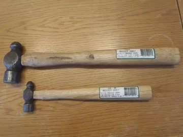

My 8oz ball pein/ peen ? hammer's handle broke.
Where would I get one?
The big box stores have the 12oz ... ohhh were to look? :oops:
Hardware store...might be able to get a replacement handle there or maybe a whole new hammer if they don't have handles

Handles are on I'll let them soak in boiled linseed oil.
