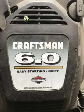

Replacing a gas tank on a Sears Craftsman 22” push mower purchased Aug 2001?

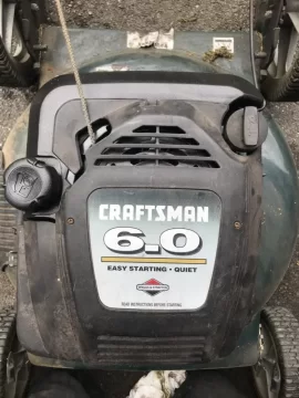

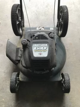

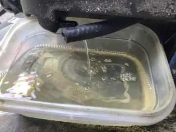

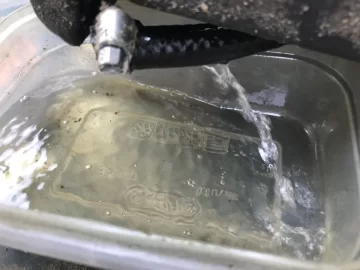

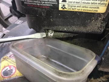

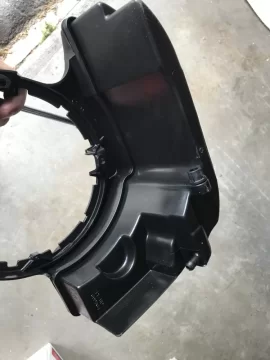

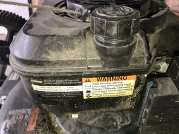

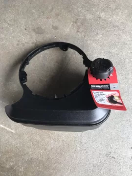

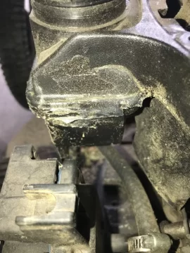

This year there was a crack and if the tank is filled to the top it leaks about 1/4 of the way down and stops. Briggs & Stratton engine. Very common tank. I tried high temp silicone RTV but no luck so for $36 I got the new Plastic tank.
(broken link removed)
Is a Fuel Preserver worth it? See pics below.
Is it easy to replace?
Well
Not too shabby.

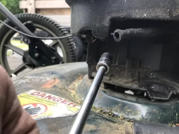

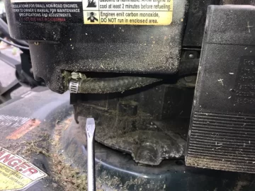

All it takes is a Phillips and flat blade screwdriver & 1/4” socket set

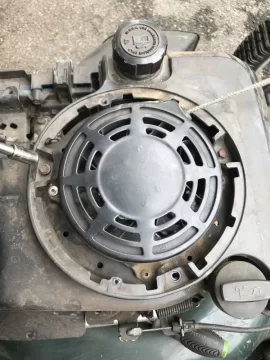

1. Remove 2 screws from the top plate
2. Remove 3 hex head bolts from ring flange

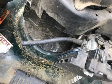

3. Loosen radiator clamp with flat head
4. Put gasoline catch cup underneath or make a spill
5. Remove fuel line
6. Remove last hex head bolt under tank
7. Remove string pull handle from catch hook and slide tank off of pull string.

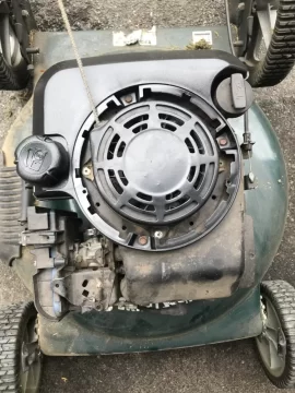

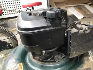

Reverse steps to re-assemble

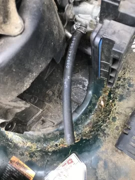

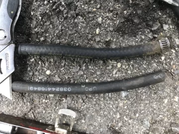

Even though fuel line was 19 years old and still good, I replaced it with standard 1/4” fuel line. I always keep a hunk around but easy to pickup at the local auto parts store.
See pics below

It is obviously not a long term fix, and the duration is probably influenced by vibration. The gas and soap interact resulting in a putty.
