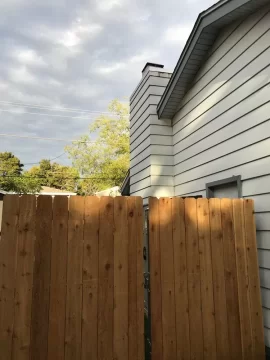

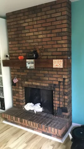

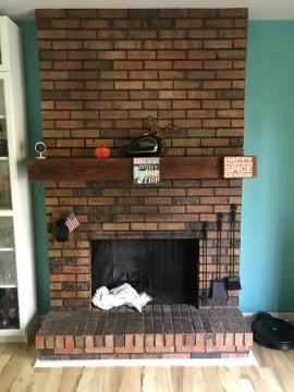

Hello all, I'm a complete novice so I thought I'd reach out to the experts for your thoughts on a project.
I'm in a house built in 1974 and the zero clearance unit looks to be original to the construction. Recently there's been a slow drip during rainstorms that comes through the space between the brick facade and the firebox. Last year I had the cap replaced and sealed. I also sealed up the joint where the chase meets the shingles/flashing but the dripping remains. Second the unit looks to have been modified by the previous home owners to utilize natural gas for fuel but I'd like to use wood fuel going forward. Lastly the brick facade looks dated so I'd like to take it down and replace with something more appealing.
With all that said, I'm trying to understand the scope of replacing the old zero clearance unit with either a freestanding (Preway or Malm) type unit or with a more modern zero clearance unit. I'm not especially attached to either style but rather does the complexity of the project change much with either path?
Any recommendations or feedback would be extremely helpful. The chase is uninsulated, so I expect insulating and drywalling if a freestanding unit is the way to go would be required.

Are you sure that is a zero clearance unit? It really looks like a heatform to me. Especially because it looks like a clay liner sticking out the top

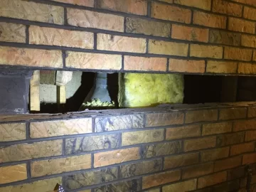

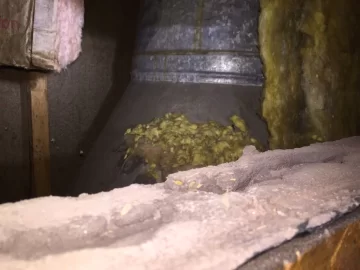

Great question! I'm not 100% certain. I caulked up the mantel piece last spring and snapped these pictures while it was out. It looked like the box itself was carbon or stainless steel and the ducting looked to be galvanized all the way up to the cap within the chase.

It's a ZC fireplace. Is the goal just an open fire or as a heating unit?
Ok yes that is a zc just not one i have seen before.
