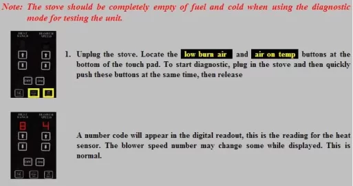

Well it looks like it could either be the heat sensor or the lower auger motor at this point. So since this is a 2004 stove and does have diagnostics then this heat sensor test should give the info to help here.
Here is the KEY instruction!
So if the blower speed reads 9 then the heat sensor is NOT reading the temperature. (According to Mike since the diagnostics info below does not say that.) :)
If it read a number that changes like 4 or 5 then it is reading the temperature properly.
http://www.englanderstoves.com/help/PelletStove/diagnostic_mode04.html
