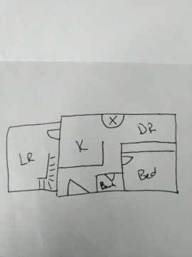

I've attached a rough floor plan of my house. The x is where the stove sits on a raised brick hearth with a brick wall behind it. The main rooms to heat are the living room and the kitchen/dining. Our main bedroom is directly above the kitchen/dining. Regular 8ft ceilings. The house isn't drafty but it could be better insulated upstairs.

By the sketch it looks like heat may have a tough time getting into the living room and upstairs due to the door, especially if that is a standard 3' doorway. A fan on the LR floor blowing into the kitchen would help a bit.
