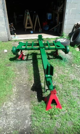

Todays progress !

I vote green as well!

Todays progress !
those old 'low riders' always look like it would be a lot more bending over to use, having never used anything but the 22t huskee I got, is it more stress on the old back? if so since you have it apart, might be a good time to weld up some drop brackets to lower the axle and raise the height if you get what i mean, I could be totally off though
Reactions: Pallet Pete
No need its a good height and would actually be harder to use if it where taller. That said I am going to install a winch powered lift table later this fall when I have more time to do it as well as a catch tray on the end. All in good time I suppose! It's actually built from a Mazda rear end but I have not been able to determine what model. Tomorrow I am replacing the bearings assuming I can remove the drums lol.

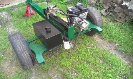

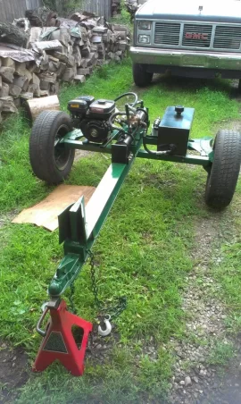

I am feeling a bit under the weather today and need some air so I pulled out the splitter to show you how it turned out. The modifications have a long way to go yet but that's a winter project catch tray on the end a winch powered lift table on the side. She looks sexy ! Thanks to Jags and a few others for sharing their advice and knowledge on this. It's my first full splitter overhaul !
Pete

Looking good.
"The Green Machine" :)
Looks nice!
I think when I do mine over I am going to preserve the old patina and just clear coat it. A rat splitter! Rat Fink sticker
