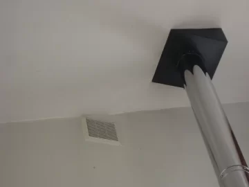

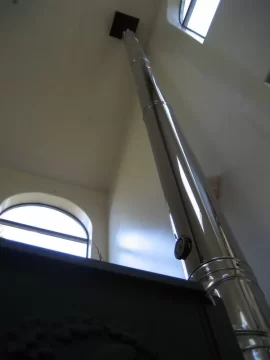

We employ a similar idea. With a whole-house 21 foot open ceiling, hot air rises off the stove and flue...
[Hearth.com] Return air from upstairs to stove room
...where a small fan up near the highest point returns the hot air back down inside the wall...

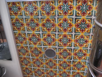

...to blow onto the stove from behind to circulate heat around the lower floor.
The fan has a convenient infinite speed control in the wall. This simple setup works great.
