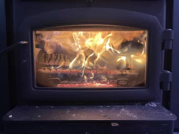

I have been trying to see if I can squeeze a little more burn time on my stove with North-South / East-West configurations. Sunday morning, I packed it full of something that was as hot as hell and burned FOREVER . Now, I am also going to have to pay close attention to what species of wood I am using. I would have never thought that burning wood was so complicated.

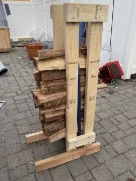

BTW
I made a jig to cut my firewood down to a size that will fit N/S in my stove. I do this every three weeks.
