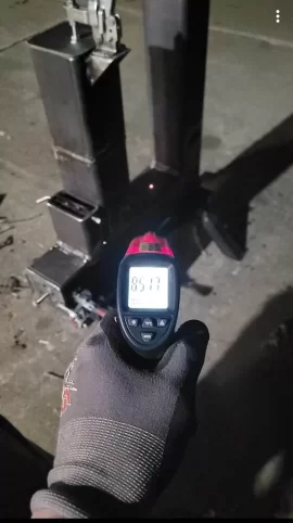

I recently built this rocket heater for my garage, and am wondering on whether I should go with a 3, 4 or 5 inch exhaust pipe. The flue going up is 4". Im new so excuse me if this a noob question.
[Hearth.com] Rocket heater.
Might as well keep it at 4".
