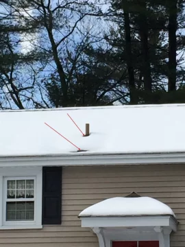

This is a very tenacious problem since I have tried many things. These houses was built in 1962 and the outside walls have approx 2" of fiberglass insulation. The stink pipe is for the toilet, tub, washer and sink.
The pipe exits the roof above the right side of the bathroom window as shown in the pics below.
Most of the houses in my neighborhood have this heat loss issue! ! !
It seems that when the snow melts, why does the snow on the roof melt here? See pics
The original stack was made of copper and only extended 6 inches off the roof. I tried extending it with pvc last year but that did not help very much
See pics >> https://www.hearth.com/talk/threads...on-the-roof-before-winter.89970/#post-1173890
So this time I tore out the whole copper stack and replaced it with PVC so no heat would not be conducted up thru! Then I opened up the bathroom wall and tore out the 2" fiberglass and replaced with ROXUL ! Then I put in a new double pane double hung window and sealed all around it with foam sealant. The worst heat loss and air leak in the old windows was not the window but the frame around the window with no insulation between! ! !
Before I closed up the wall I air sealed the gap where the ceiling sheet rock meets the top plate (2x4) in the exterior framing! Above the bathroom ceiling is 2x6 R19 Fiberglass insulation crisscrossed with R30. The roof rafters have rafter vents from the continuous strip vent in the middle of soffit all the way up to the ridge vent. with r3.8 reflectix foil stapled to the bottom side.
See 2nd pic below. It is much better but why is it melting faster at this point now? Where is the heat loss? Sorry for the fuzzy pic

I bet your pipe is blocking the ventilation air that would normally enter in the soffit, travel up the underside of the roofing unimpeded, and then out the top. That big plumbing vent is slowing the flow of air relative to the others and slow air isn't able to wisk away your leaked heat from the house so it melts the snow there.
That tiny dusting of snow could melt if a mouse farted under it.
It's an idea.
Maybe heat gain - from the sun, reflecting off the pipe? Yeah, a long shot…I like Highbeam's idea.
In the fuuzzy picture, you can almost see a reduction in meltoff at the ridge in that same rafter bay which would jive with a lack of flow.

I just found a pic of the issue before the new window, before the Roxul insulation in the outer wall and before I put the PVC in and air sealed it.
It looks like the problem has moved to the right!
The only thing that would make sense, is the fact that I air sealed where the ceiling sheet rock meets the top plate above and slightly to the right and levt of the window. I did not air seal the section to the right where the problem shifted!

I don't see how it moved much if at all. Your rafter spacing is 16 or 24, probably 24".
I'd vote for an airsealing issue near the top plate. Is there something in the wall cavity under that could be feeding the leak. That is, the gap in the plate might be uniform along the wall, but there might be something in that wall cavity allowing air in??
I think Highbeam hit the nail on the head with the obstructed air flow. It's not uncommon. If you're not getting leaking ice dams I wouldn't worry too much about it.
Yes, Woodgeek, I think you are right on track here. The proof of this happened when I took the wall board off on the outside wall in the bathroom. The warm air in the bathroom super fed the air leak between the ceiling sheetrock and top plate and made the melt mark 10 times greater!
Now in this last case, I think that because there is only approx of 2 inches of insulation in the 2x4 outer wall, that there is warm air in the cavity on the inside of the insulation. This slightly warm air is being drawn up by the vacuum created when the soffit air runs up to the ridge vent. Why it only occurs near the bathroom is another question, but because of the hot showers, the bathroom is much warmer and humid too!
I was amazed when I saw that gap between the ceiling sheet rock and the top plate! ! !
This would also explain why the melt area is close to the edge of the roof where that gap is! ! !
When I get up there and seal it I will take pics. Did you seal that area in your house Woodgeek?

Your going to get heat transfer from the pipe even if it is PVC. Not as bad as the copper, but you have warmer air traveling through the pipe, which will transfer to the pipe and to the flashing.
No amount of insulation under the rafters is going to stop the heat transfer happening between the rafters and up top of the roof where the pipe is exposed.
If anything, I would try wrapping the pipe in the area under the roof deck and see if that helps. Looks like you are doing much better than your neighbors.
A 3" or 4" vent pipe is not going to block enough air flow from the soffit vents to the ridge vents to cause any issues with ventilation, whether the rafters are on 16" or 24" centers.
Make sure you didn't accidentally block air flow at the top plate between the rafters.
R15 for walls is not the greatest, but you can only fit so much in a wall, and is surely better than R7.
I think you're looking good, and any more expense & labor would not be cost or time effective, aside from maybe wrapping the pipe in the attic space.

Thanks, I like the idea of wrapping the pipe. That would be quick and easy and stop any heat transfer to the pipe! Thanks alot!
As long as the living envelope is adaquately insulated, you should be opening vents in the soffit to cool you attic space. There will always be melting, but if that melting is premature than you need more cold air in your attic/rafter bays to keep your roof cold.
Agree, I have rafter vents from the soffits all the way to rhe ridge vent. Under the rafter vents I have R4 relectix foil. That gives plent of cool air under the roof! No ice dams afetr doing that!
