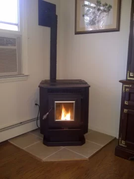

    Adjusted to 4-2-1. Noticable improvement. Heres a pic of the install and a pic of a ton of pellets in my half ton truck. It was only about 8 miles.

    Nice clean install Scott M,.. and if it ges too warm you can simply reach over and click the A/C on! lol! ... nice job and welcome to the forum.

    Yes... That A/C does the whole house in the summer and the stove can do the whole house in the winter. Its the Climate Control area LOL... The propane company has been sticking it to me for 27 years. I should send a pic to them too...

    You might want to photoshop a surge suppressor into that pic before the surge police see it!!

    ut oh,... here come the police!

    Install looks great! Really liking the truck too !! I'm wanting to get back to a Chevy/GMC full size. Oh and on the Police side look into a surge protector for the stove, no unprotected burnin !! Sounds like your not going to have to many problems keeping warm this winter. Good luck!

    The stove came with an O.A.K so I installed it. Thanks for the PM on the surge protector. Ordered it up. I am running it on a generator now thanks to hurricane Sandy. The Chevy does OK with a ton in it. I wouldnt want to do it on a regular basis or for more than 30 miles or so. Got pellets at the tractor supply for $214. The Lowes and Home Cheapo were $209 but I didnt want to drive 20 miles to save 5 bucks. I am a cheap Scotsman but not that cheap
