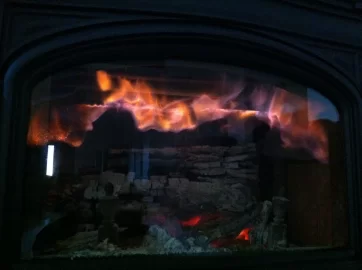

I have the cod in a pretty small living room. I never feel like its running me out. Moving air around the house is key, this will be the case with any stove. It runs well on low!
  • [Hearth.com] Rookie thinking of Cape Cod
Reactions: PapaDave

Here is a little video of my Cod running on low. It can be pretty mild if need be.
Great video Webby! I'm almost sold, but I've also heard some pretty steep prices on the Cape Cod. Haven't priced it out yet, but I can get the Encore for 2795. Obviously, if the quality is still an issue with VC, that's irrelevant, but the $4K I've heard on the Cod might be pushing it.

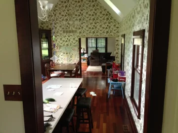

There are lots of non-cat options that would work here, especially with some air circulation. Is there a ceiling fan in the addition? If you can post a sketch of the 1st floor plan we can suggest some ways to assist airflow. Pics of the room, proposed stove area, connecting doorway etc. also will help.
This is a view from the original house into the addition which are the two rooms I have problems with. The stove would sit on the wall where the kitchen table is now. You can see the hexagon room through the next doorway. There is a ceiling fan in the kitchen.
Good about the ceiling fan, it will help move the air. I see a small problem. Mechanical code says that a return vent must be at least 10 ft away from the stove. Check with your local inspecting authority to see if this will be an issue or not.
What do you see when the camera is turned 180 deg, pointing into the old section of the house? That is where I am thinking of suggesting putting a fan. This might be able to be built into the kitchen wall if there is no convenient location outside this doorway, but it would help to see the wall and doorway to see if there are other options. Maybe even a transom window?
That vent is actually not an air return. I'm not sure what the thinking was on it, but it appears to just be a vent between the rooms. Directly behind the camera is a 12 X 25 ft living room which would easily accommodate a ceiling fan. A 90 degree turn then leads the entryway with stairs followed by a 10 X 10 room. There is a landing and two bedroom upstairs above the 12X25 and 10 X 10 downstairs rooms.
