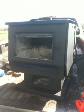

Thanks, realstihl for the heads up on that listing. I now have it in the back of my pickup, and a pipe wrench and cheater pipe pretty well straightened out those bends. Not perfect, but will do. Waiting on my wife to bring home a rattle can of paint.
She was built in Nov. 2007 and hasn't seen a whole lot of wood. No cat, but the door is good, and looks like the thermostat is good, at least it turns smoothly. The left side shield also has a dent in it, and a couple of bricks broken, but they will work fine for now.
The owner said the bends were there when she got the stove, so I don't know the story on how it got bent, but would guess it was dropped. Nothing else shows any stress though. The door would have had to have been damaged at the same time, and the one that is on it is fine.
Cost for new cat, and a few other odds and ends will take it out of super bargain range, but still a good deal for a stove that should have lots of years left in it. The King will be assigned to the shop for duty. The princess should be a better fit for my stove room. Makes me look forward to winter. Not.

Well here are the before and after shots, not the best photos, but hopefully show what has been done.
Looks like a smokin' deal to me! >>
