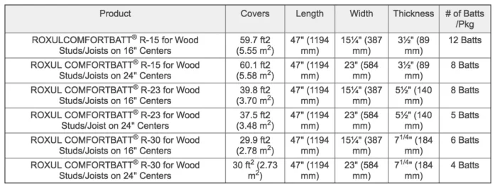

Hey guys...just a quick question. What R rating Roxul Batt should I buy to insulate above the block off plate and up in the damper area??
thanks!
3.5" thick batts are fine.
Thanks Begreen...when I was looking online at Lowes for Roxul batts they have different R values, does that just refer to the thickness?? Just want to make sure I get the right one?
Yes. What ever you get you will have a lot left over.
