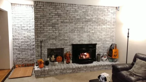

Hello all. I looked using the search but cant quite find the answer. Would it be ok to stuff roxul in and around my insert? There is some space I could fit some roxul in and on top of. Can I lay some on top as well? I would do it so it is touching the insert. Thanks for your response!

What kind of insert do you have?
I don’t think you would want to lay it on your insert.

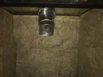

Yes, it’s a good idea. I just did mine. I insulated above the block off plate and around the insert.

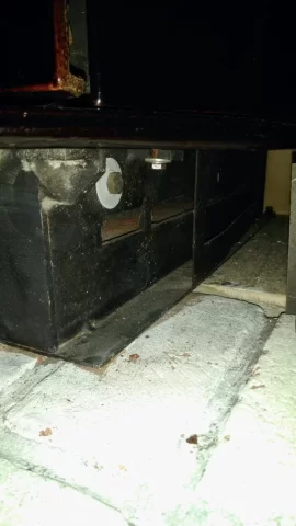

Do you have a block off plate?
Webby3650 Master of Fire How did you attach your Roxul to the back of the box?
Roxul bats are very rigid, almost like insulation board. If you cut them to fit tight, they will stay put on their own.

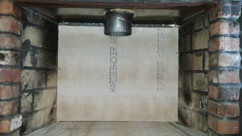

Id cover it with dura rock as well otherwise alot of fibers will blow in the living area. Ive heard spray it with heat paint also works.
Blockoff plate and insulate above that b4 you install it.
I did the roxel/durarock on back wall, sides aren't exterior.

How will fibers be blown into the living space? Blower air enters the bottom of the stove and exits the top, it’s a sealed convection jacket.
I would also recommend doing the sides as well, even if it’s not exterior. The stone sidewalls will still soak up that cold from the back and radiant it through the sidewalls.
Mine has slot openings on the lower sides, fan blows into channel and grabs air from behind also...

I don’t really like the sound of that design. Most units are sealed up pretty well, so no particles insulation could make their way in.
Not to mention, diluting the hot air being forced through by the blower.
I was kinda short on room to do the sides and being it wasnt outside i just did back, i agree it would be better of course.
Ive read on here people saying to paint the roxel so particals wouldn't come into room. I still see some fibers, is it roxel idk. Maybe from around liner and blockoff plate.
I just pulled my fan, the slots are not in the fan channel but where the stove grabs its primary/secondary air, so yeah i see what your saying...

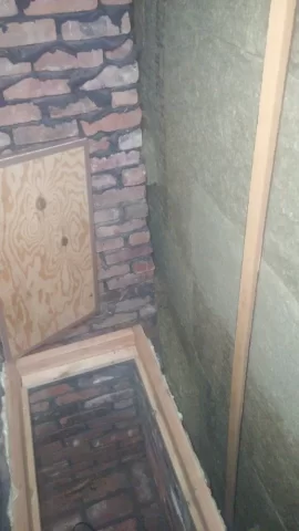

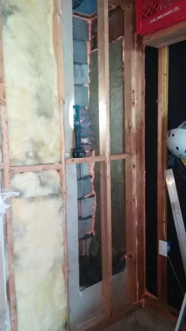

I had plenty of room, so I stuffed full! I’ve been dealing with ice cold stone. I’m talking 27 degree stone!
I was able to get to get back up behind this whole damn brick disaster and airseal/roxel as well!
Left side up through wood storage
[Hearth.com] Roxul
Right side access from garage
[Hearth.com] Roxul
From inside view
[Hearth.com] Roxul
This area was so cold b4 i did this stuff, there was 0 insulation separating brick from outside.

Davo- don't lay insulation on top until you check with the manufacturer. They might also want a gap around the sides. The possible consequences are overheating and wrecking your stove.
You do want an insulated block off plate above the stove. If you can insulate the backs and side of the fireplace and maintain whatever gap the manufacturer recommends, and keep your air intakes clear, that might help a little, too.

There should be no air circulation behind the insert. It's very unlikely any fibers would be blown into the room.
Reactions: webby3650
I still think fibers fall off and make its way into the room. Yeah the blower channel is not connected to the back area, the air intake is but that would just suck the fibers into the stove and rid them.
I just see shiny little fibers on the top of my door where blower blows out. My back has durarock so maybe it comes from the hole the liner goes through and as that gets hotter it moves fibers, idk lol
Its not alot so im not worried...
