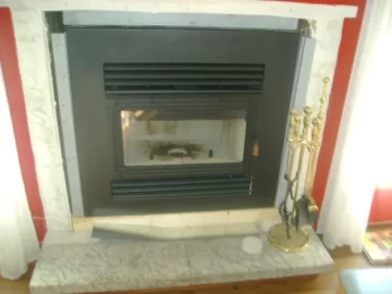

I am in the process of potentially swapping out my larger onyx with the pearl 3600 by rsf-icc. It mainly will come down to IF the heat dump will work or not. It would be ducted to the basement directly below for supplemental heating. If it doesn't work I will simply leave my current fireplace and just do a updated makeover. Now my onyx is around the vicinity of 41-1/2 inches wide and upon remembering the install of the unit, there was some room left on both sides, about 4-5 inches roughly. Now the pearl 3600 itself is 34-5/8's inches wide and is much smaller than the onyx giving more room on both sides. I added an image from when my current fireplace was installed for a visual idea. I am hoping someone here knows this type of stuff well, and could give me some insight if there is any way to make this work with very tight clearance space as my basement gets very cold, so this system would help me out greatly.

Is the current fireplace in a brick opening or a wood framed opening? It's kinda hard to tell from the pic you will need some "head" room as well as side room in my opinion. The folks at rsf should be able to help you with size requirements.

Hi thank you for you reply. It is not brick but wood framed with some sort of dry board finished all around. Problem is they won't know for sure until the stone is taken down and they can see in, and that's of course if i had bought the unit.

Didn't the Onyx have a central heating ductable option? That seems like it would be a less disruptive and much lower cost. What is area is adjacent to the sides of the framing for the Onyx? Is this interior or exterior framing?

The chase is exterior to the house and the face of the fireplace is flush with the living room interior wall. There is a central heating option but due to the placement of the fireplace it would not work for us. The last ditch effort would be the heat dump installed with the pearl. I attached 3 more pictures that might give more of an idea as to the space I am working with.

Yes, that's very helpful. The nearby window reduces the option for expansion on that side.
Question: Even if the Onyx was replaced how would the hot air duct from the fireplace get into the basement when the fireplace is cantilevered outside of the foundation wall? Were the joists extended an addition 2'+ under the chase?

You have a good point there, I thought the joists had extended a bit under the chase just enough so that maybe they could angle it some how. But upon further investigation I did today, the fireplace does seem to sit too far from the basement ceiling. I just assumed maybe they could angle it through some how and it would just fit. The unit heats the upper two levels great, but the basement gets freezing in the winter.
