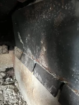

Looked inside the stove today and this is what I saw. The last several (5 or 6) fires back in April were full throttle (bypass closed, thermostat all open). It cleaned the firebox and glass very well. Should I be concerned?

Looks like surface rust to me. Would probably come right off with a wire brush
There was a previous thread about this a while back. It appears it’s from the humid summer air making its way into the stove during the off season. Some say damp rid, moisture absorbers, or disconnecting the flue during the summer. I was told the first fire will take care of that small amount of rust. I used damp rid this summer.

In the manual for the pellet stove i used to own, it said to spray down the firebox with cooking oil spray. It worked great, no more rust. I don't know if it would be ok to do in these stoves with the firebricks or not.

I would be more worried about the catalyst. But pine has lots of “oils”. Long hydrocarbons and the cat does fine with them. Damp rid and disconnecting the flue would be my choice
