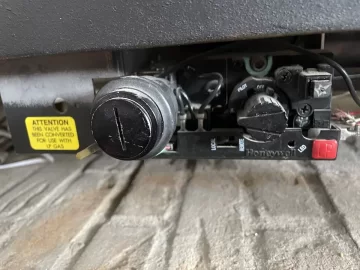

pilot lit. thermocouple voltages 480 and 525 . remote won’t turn on main flame . new batts.
local setting no flame either .
tapped on valve no change
valve original 2003 era
last month flame same height at all settings above 3
propane fill 2 weeks ago
any way to lube these valves? exercise them manually ?
