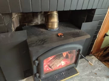

I have a small Napolean 1101 insert - small stove in a small fireplace it just barely fits within spec. I actually like that it sticks out farther this way than an insert often does.
Anyway, the stove is working great, but the only negative is that the fan is a little louder than I'd like. It pulls air in from the front at ground level on both sides, you can see the little grates. That routes around back and is recirculated up the back and across the top and out right below that full front lip. Works great but is kind of noisy. I know that stuffing the back area with rockwool, or at least wrapping all the ducting sheetmetal and the blower would help a bit with acoustics. I'd probably end up having to wrap some of the stove itself too though, and I'm wondering if that could be bad for the stove - maybe overheating or something?
I don't see anything in the manual about it. Also, I'm not worried about the rockwool itself combusting or anything. Just wondering if it could negatively affect the stove.

As long as the insert does not overheat it should be ok.
Does the hot air come out from below the stovetop through a slot on this insert? If so, the stovetop temp is not an accurate measure. In this case, it's better to measure on the stove face above the door.

That's a great point - can't believe i didn't consider that! Yes, it's a double top with an airspace between the real inside wall (1/4" plate) and the external top... slightly lighter gauge plate. I've been double checking things with a IR thermometer and it never dawned on me why the front face was hotter than the top.. .duh.
