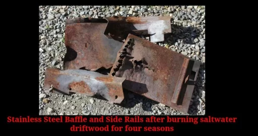

Yes salt is bad for your stove and your chimney. But the amount that is on your wood is so small I doubt it will make the slightest bit of difference. Drift wood on the other hand can cause big problems.

I would burn it to because the levels of salt on the wood will be very low but salt is really corrosive it will destroy the liners in the chimney whether they are clay or stainless. Yes wood ash and creosote are corrosive to but liners are designed to deal with it they are not designed to deal with salt.

Again in this case I would not be worried about it at all. But there have been plenty of cases on the coasts were people either burn allot of drift wood or their wood stacks get salt spray and yes it does get up the stack and yes it will eat up any liner and the stove. It is not common at all though and most people have nothing to worry about.
(broken link removed) on burning driftwood and dimensional lumber/mill ends.
