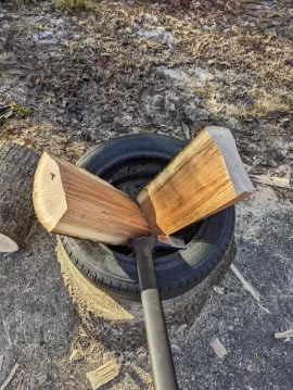

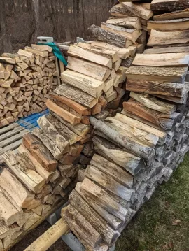

Yup smells like 80F+ inside.Got some good work done today. I love splitting red oak it just pops. I like to do a variety of sizes and shapes. Some big some small. Lots of rectangles from the bigger pieces. The variety helps with stove tetris down the road.
Anyone who burns a lot of red oak knows exactly what this pile smells like. 2 parts cat piss, 1 part vinegar:
