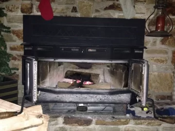

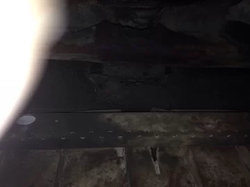

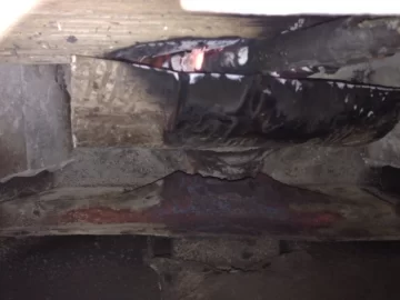

Here we go again another option for us. My old Country Comfort i thought was just severly neglected and beat to death. well it is but still a beast of a stove. I thought several parts were broken/warped and shot. Now futher knowledge and investigation shows she just needs some tlc. Tell me what you guys think here. Instead of spending the money on a new stove can I save this old one and bring it up to par? My thinking is this, the stove needs a new Cat which i found recently online! The baffle is not warped it is actually mising two bolts holding the right side of it up, easy fix. Now it is currently a direct connect. It has about 10 foot of oval stainless running up and dumping into 13x13 clay flue. In my recent chaos posting fury I was thinking another option could be to run 8" SS liner down my clay liner and simply use a 8" to oval adapter and place it on top of my current stove. I Would also add a block off plate and roxul above the old damper frame and block plate. If I run 8" i figure that gives me the future option of sliding the current CC stove out and pushing a new one in when we finally decide on a replacement stove. Then I would already have the large 8" required on most larger stoves and all I would have to do is remove the adapter and drop it on top of the new one! Is this a viable option and would doing this with my current stove actually improve its heat output significantly? Or is a new stove going to blast off that much more heat into our house? Thank you again for the help and tolerating my rambles.

any advice on how to tell air inlets located on the bottom sides of my stove are actually functioning? I also have a secondary burn tube on this stove it seems. I have no manual so any help with proper function is appreciated it is a Country Comfort cc 325

AT least get a liner all the way up
