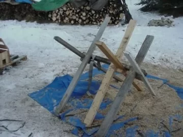

Trying to post pics again...
  • [Hearth.com] sawbuck for dummies

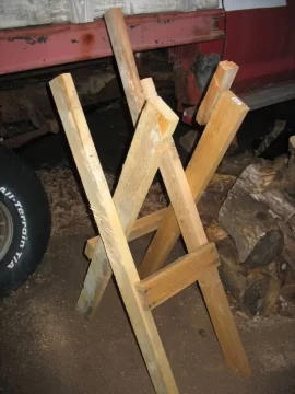

another angle (Posting seems to be a problem right now...)

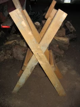

We have a sawbuck with 6 feet, i.e., 6 2x4s, not just 4. We had it with just the 4 for some time, it was okay but for short pieces I always had to hold on while hubby cut or they were falling down. He just added the third leg in the middle, close to one end, and it is SO much better now. He can cut things that are a lttle too long, and also have really long pieces held up by it. The whole thing is about 4 feet long, the extra set of legs is near one end. We can cut between the legs and feel safer because something is between us and the chainsaw, and the wood falls down a lot less, even after cutting. We can accomodate almost any size log it is strong enough to hold since the legs go up some distance on the top side. We used all scrap lumber so that is why they are different colors . . .
