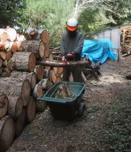

An alternative idea for limb wood is essentially a hole into which you stick one end of the limb, so that the whole thing is cantilevered out into space. I've done something like this using a woodpile:
  • [Hearth.com] sawhorse plans
What I did was to take an old junk 4x4 (a mailbox post that had rotted out at the bottom) and screwed a pair of 2x4's (also scrap) across the corners on each end. I may add a pair in the center to support shorter logs at some point.
Total cost was a handful of Deckmate screws since all the wood was recycled scrap. The way the 2 x 4's cross above the top of the 4x4 gives a short gap between the log and the sawbuck when cutting, and the 4x4 has enough meat on it that it really doesn't matter if you cut into it a little.
