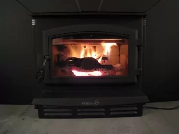

I just recently purchased a Enerzone 2.3i wood insert. This is my first insert and would like to share my experience with it. I haven't read too much about this model here on these forums. I installed it on the upper level of a ranch with a basement. Its installed in a 13x13 terracotta lined 16'(from fireplace floor) chiminey. I installed a 6" insulated flex liner from http://www.chimneylinerinc.com/.
I can say I'm definitely saving money over using my electric radiant heat which is in the ceiling. After 3 hours or so My 1400 square foot upstairs is warm. obviously warmest in by the stove and warm enough in the bedrooms that the heat doesn' come on. I am not using any hallway fans just the blower that came with the stove.
This is my first stove so take this for what its worth. I am pleased with my purchase. It cost around $1500 for the stove.

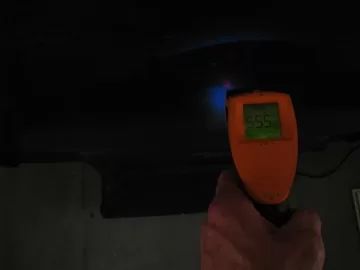

Here is a short video of it with the fan on high. and air shut way down. Also some pictures.
A question I have is what is a safe temp to run this stove at. Is there a max?

Your owner's manual says to not exceed 840 degrees Fahrenheit on the cooktop of the insert. Personally I wouldn't get it over 650F - 700F.
