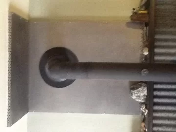

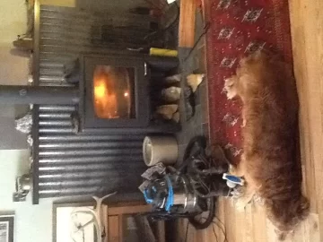

I have a pretty tight installation as well. One of the nice things about the A10 is it has really good heat shields on the back and bottom of the stove. With my installation I had to go up and out to get into an existing chase. There was a ceiling joist directly above the horizontal turn into the wall. I built a heat shield out of cold rolled sheet steel. It is held off the wall and ceiling with 1" square tubing. The ceiling part actually has two layers with a 1/2" space between them. I felt the holes I punched at the mantle and top front edge would allow air to naturally circulate. I used dura rock rather than Sheetrock as well. I also installed a thermometer probe against the joist directly above the horizontal pipe. When I have my stove fully running, the temp against framing above the stove is never more than 10 degrees warmer than room temperature. I can place my hand against the heat shield on the wall behind the stove and it just feels slightly warm. I used single wall pipe to the wall pass through, using double wall pipe would reduce temps even more. With flue gas temps running 600 degrees, the surface of the heat shield is 105 on the wall and and 185 directly above the elbow. 1 inch above that it's 78 so I know the heat shield is working as designed. Definitely, you want to maintain proper clearances to the roof framing. [Hearth.com] Scan Anderson 10 install questions [Hearth.com] Scan Anderson 10 install questions
