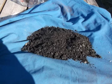

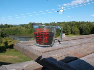

Now we cleaned the chimney, brushes up and down several times produced 3 cups of flaky creosote. Pics show what came down.

Considering that you are transitioning to very larger flue sizes ( hence the gasses slow down and condense on the walls) you look to be doing pretty good. Question what is the13x7 lined with?
English Bob's Spouse later that day: Bob? Do you by any chance know why our biscuits taste as if they've been smoked? It doesn't have anything to do with you borrowing the measuring cup earlier today does it?

Well then. drop a liner down that craw. 5.5 or 6" plain liner and block off plates at either end at minimum - cause what you have at present is considered a slammer install. with the block off at the bottom after putting in the pipe you can get proper pourable insulation for around the pipe to fill void. Lot less worry about nasty black stuff as flue will stay warmer and the gas flow faster less chance for that kind of build up when you least expect it. Plus the stove should burn better and be easier to light.
I have about 10 ft 6" insulated + the 5 or so feet of double wall inside maybe get a cup of stuff out of the flue after 4 -5 cords worth for the whole season, Kinda a dark gray to a bit of black mixed in from right at the top
I get about double that from the 20 some odd ft flue which is a single wall liner in a masonry chimney with poured insulation around it- that is connected to a 1300 hotblast furnace- not what you would call efficient. This in the basement.
