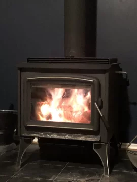

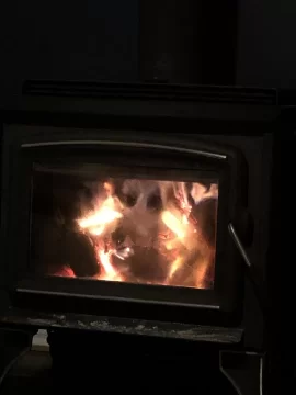

So last week or so I’ve noticed when I close the bypass on my stove to engage the cat the roaring flames immediately go out.
I don’t remember it doing this before unless I turned the thermostat down. Cat stays engaged though and my burn times seem about the same
Since we burn 24/7 I took advantage of the sudden warm spell to let the stove shut down to look things over. I cleaned the chimney and cap and then made sure the combuster was not clogged on both sides by brushing vacuuming it. Seems ok.
I’m burning the same wood as before, moisture content is under 20%. Anyone else’s stove do this? If I open the bypass I can see the coals glow immediately as the air rushes in and the fire quickly goes back to inferno mode.
Is my thermostat maybe sticking? How do I check it? The knob and rod turn and I do hear it clang shut if I turn it down more then halfway but not sure it’s opening fully

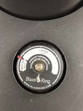

Picture is stove after closing bypass after 20-40mins still on highest setting stove temp is maybe the first little notch above inactive. It’s very possible it’s cat replacement time we’ve had the stove 4-5 years and burn 24/7 for 8-9 of the 12 months. That has to be over the 10year life expectancy of a cat lol

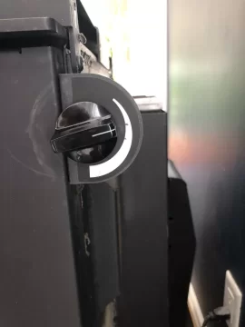

I’ll also check the thermostat make sure it’s not stuck or anything when I work on the stove. To me that seems to be more likely the fire goes right out immediately when I close the bypass. There’s secondary flames from the hot side for a minute but then just dead/coals even when set at the highest

The Tstat should be supplying air regardless of whether the bypass is open or closed. The immediate die down does not suggest it's the thermostat, imo. The thermostat can't even do anything "immediate", or within a minute.

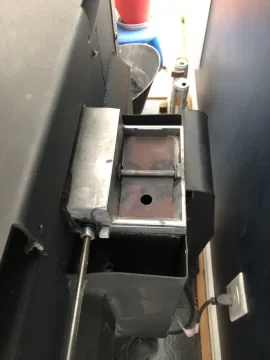

Ok I’ll try that I’m letting the stove cool off right now. I took the tstat cover off. Seems to move with the knob and open and close. I have it set where it’s closed right now too see if it opens up as the stove cools (just between2 and 3o’clock on the swoosh)

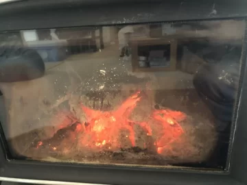

Thermostat seems fine so I compressed air the cat as suggested and that made a big improvement still not 100%. But maybe a few hot burns will get it even better. New cat on its way regardless.
This is 20mins after closing bypass, still in fuego! (Sorry bad picture to lazy to get off the toasty couch so used the zoom. :). ). Edit: turned down the thermostat and still have flames. Workinggood thanks everyone!
