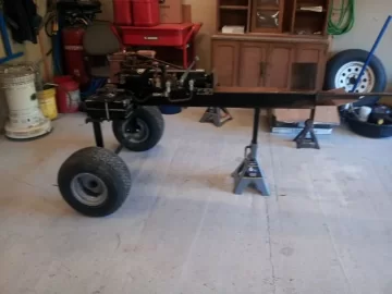

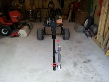

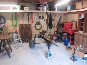

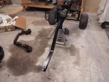

Operation log splitter lift kit got started yesterday. Still need to add some bracing to the axle. It's strong enough as it is for my intended use but I usually over do things just in case my, or the next owners, needs change. I'm sending a length of 2" square tubing with the neighbor to work, they build mowers and have metal bending equipment, to form a drop hitch to weld under the main beam. Then just need to make a kick stand to support it and should be in decent shape. For now anyway.

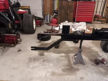

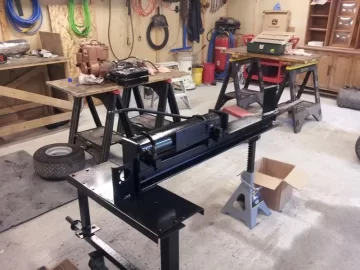

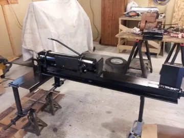

My Fathers Day present to myself was some primer and 4 cans of gloss black spray paint. I ended up with 2 cans of gloss and 2 cans of flat because someone decided it would be funny to switch out the caps that indicate color. Oh well, guess another coat won't hurt.
Anyhow, I should have the tubing for the hitch back from the bender soon and then I can get this project wrapped up.

Used an old unit just like that one for 3 or 4 years. Split almost 20 cords on it. I was getting ready to change things up and add a lift to it like you did when we moved and left the old girl behind. Now we have a new 27 Ton unit. It was a dependable old machine only problem I can remember having was the forward loop that held the ram broke (most likely from over working it) replaced that. Never had an issue with anything else. I did remember that the reservoir was small and that fluid would get a little warm if we were using it for long periods of time. For 100 bucks and the time you have into it you should have a dependable splitter. Also very easy to repower with a new engine, ours had been replaced shortly before I got it.
PS how is that SnoWay Plow working for you, got one last year only plowed a and full of times with it so far?
I have the same splitter, got it for free at my wife's grand-parents farm. Her grandpa was a welder and made a larger reservoir for the hydraulic fluid because of over heating. When I picked it up it had the original engine that was blown and a bad seal in the ram. The seal was a easy fix, but getting clip out of the seal was a pain. I picked a new briggs off eBay and it lined up perfect on the splitter. It really is a good splitter, but mine is gonna get a lift too! One year of splitter 7 cords on your knees is enough. Overall for a your $100 initial investment I think you got a really nice unit.

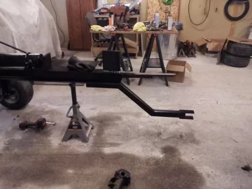

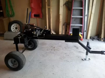

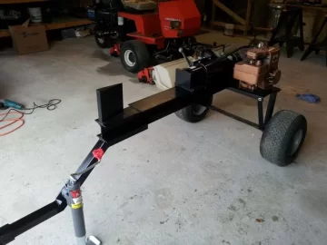

Got the drop hitch welded on and painted. Still need to cut the old hitch off but getting closer to done. I was worried about the small hydraulic tank and heat build up so I will likely add this tank to it after some run time with new oil to give her a good flush. http://www.northerntool.com/shop/tools/product_200466863_200466863
Only other thing I'd like to add to it as of now is a jack for the front the splitter so I don't need to keep it hooked to the golf cart or tractor. Not sure if one with a wheel for ease of moving would be a good choice or not. Something like this is at the top of the list for now. http://www.northerntool.com/shop/tools/product_200466904_200466904
Sorry about the messy shop pics. Been quite a bit of work coming in lately.
