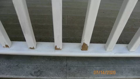

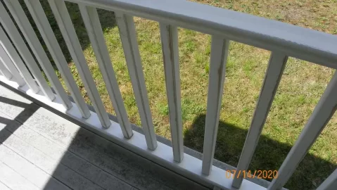

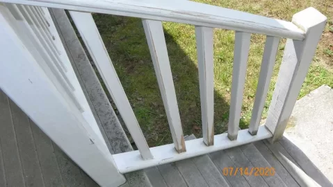

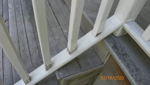

After a day out on the water, I finished up sanding some spots so hopefully Mother Nature allows me to get once coat of primer on. I'll go with two coats of primer and one coat of paint on unless some of the worst needs a second coat of paint the all of it will get the second coat. The attached pictures are from the first scraping and sanding, I went over it a second time and then checked it again tonight.
After the above is done, I'll start on the other side.

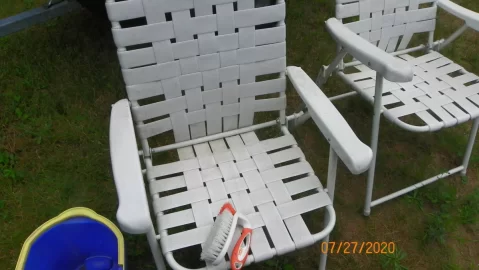

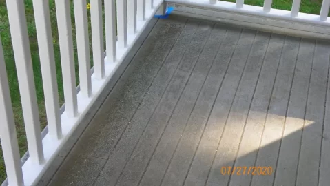

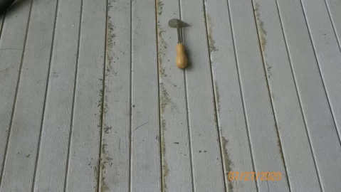

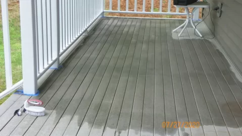

While having coffee this morning, I changed my plans and cleaned one side of the TimberTech on the front porch. I used what I call a teardrop scraper to clean out the grooves especially where the weep holes are, I then vacuumed all the sand and dirt up.
After that I took clean water with an HDX scrub brush and I cleaned the TimberTech on that side, six buckets of clean water and that part was done until I decided to use a roller mop to clean up the dirty water.

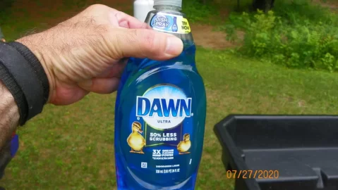

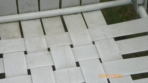

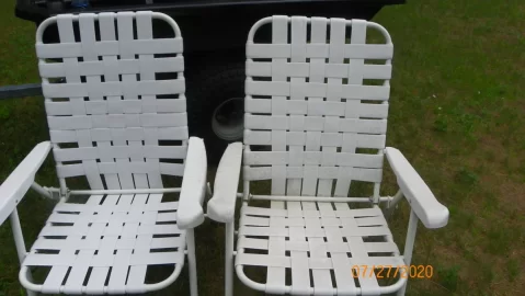

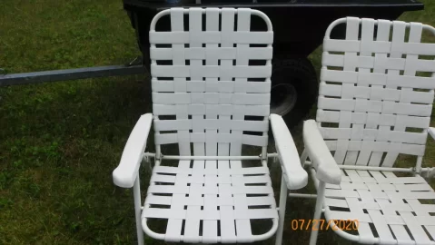

After I was done with the above, I cleaned the four chairs we have on the front porch with water and Dawn, that worked out great.

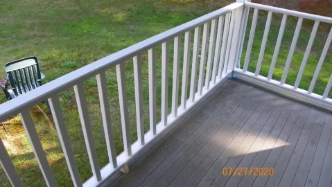

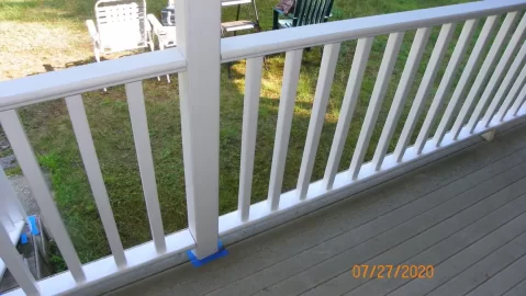

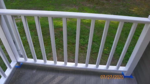

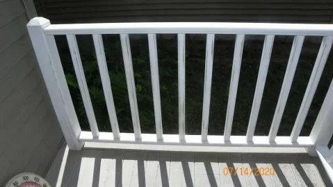

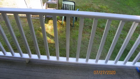

I haven't put many pictures of the painting up so I took some today.
