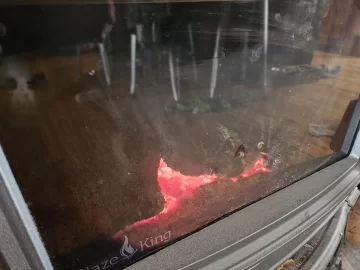

I want to add that I'm having a lot of coal build up. Cleaned the stove 5 days ago and the coals are 5+ inches deep and almost coming out the door so they arent burning down all the way. This hasn't happened before. My wood is less than 20% moisture content. I usually run the thermostat at 25% and have room to turn it up. Currently running around 40%. But see no need at 35 degrees to run it full out. I dont want to blame the stove because it's ran fine since I started it up 1.5 months ago.
I cleaned out the stove except for a 1/2" of hot coals. The 2nd picture is with the thermostat all the way up after an hour of burning. Ive never had to run the stove past 50% except for initial start up. The wood seems to be getting charred, but not buring all the way through. Even though my wood is good on my moisture meter and it's sounds like it's supposed to (hollow) when you hit it together.

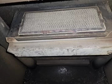

Check the cap if it has a screen. Reduced draft will reduce heat producing performance. Check face of combustor for fly ash accumulation.

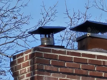

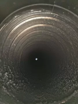

Unsure the kind of tree, want to say it was locust. But i mixed it with red oak. I'm burning 75/25 red oak to mystery wood. Tested moisture a few times through out the 3 month burning process. These events just start a few weeks ago. Cleaned it out inspected cat and looked up flue. Will go up on the roof after snow melts of, but spark arrestor in stove and chimney cap is clean

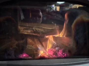

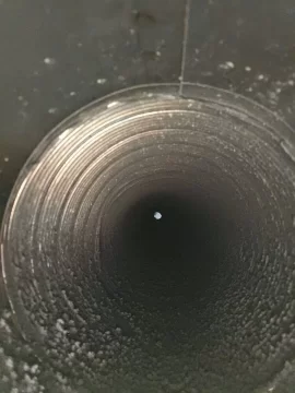

Update.... called dealer and Blaze King, they are puzzled. Cleaned and restarted twice. Cat is clean. Will check chimney cap after snow melts of roof. Hard to see because of the reflection and finger prints. But this is what the burn looks like after leaving door open for 10 mins and letting it rip. Then closed door and closed bypass. It looks like its running on low. But am staying in the active zone. Is there an intake for the thermostat I can check to see if its clean and clear
[Hearth.com] Seasoned wood charring, cant keep temps in house up [Hearth.com] Seasoned wood charring, cant keep temps in house up [Hearth.com] Seasoned wood charring, cant keep temps in house up [Hearth.com] Seasoned wood charring, cant keep temps in house up [Hearth.com] Seasoned wood charring, cant keep temps in house up [Hearth.com] Seasoned wood charring, cant keep temps in house up [Hearth.com] Seasoned wood charring, cant keep temps in house up [Hearth.com] Seasoned wood charring, cant keep temps in house up
That doesn't look gunked up to me at all, really looks clean.

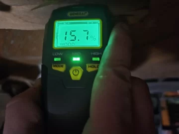

Your MC should be checked at room temp, on a fresh split, and in the middle of that split.

I wanted to write what more above wrote. How did you measure the moisture content?

Split and measured 3 places across fresh split. Wood is also super light and hollow sounding when banged together. I will try another analyzer. But the wood is dry. I want to check the intake, no idea where it's at
