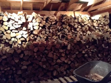

I'm one of the unfortunate ones on here with not a lot of sunny places to season my firewood. I do, however, have my firewood under a large, open, pole wood barn style roof. It's open on all sides. I have about 6 or 7 cords now cut and split. Do you think hooking up one or two box fans this summer would help in seasoning my firewood, even though it doesn't get sunlight? [Hearth.com] Seasoning Firewood

i thought there were no sides? Nothing else needed. Pic looks like sunshine is coming thru the roof
I think that with your " large open pole shed with barn roof" you are already way ahead of the curve. Moving air is key, sun helps . Wood will keep losing moisture until it hits and equalizes with the surroundings. Just need to provide adequate air flow space around / through/ under each stack. If its all jammed tight together it will take forever. Rain on the exposed sides won't hurt anything flashes back off in a couple days. You could add drop down tarps if the weather is going to be nasty for several days.

Are there 6 or 7 cords in the shed now? If so, your problem, like blades said, is that the wood is packed tight and deep in the shed. The middle and downwind side of the wood won't get much air. If you have dead wood and no Oak, that's better, but if you need all this wood for next season, it's gonna be iffy. I know you said you don't have much space to stack but if you could pull a couple of rows out of the middle, where you just have two rows, then a two-row air space, two more rows etc. that would help....

Heating air will cause it to rise, adding moisture to air with no heat will cause it to fall. Since you say that your pile gets no sunlight (can I assume the shed is in the shade?) it is not being heated, therefore all of your moisture is either being pushed out by the wind or falling out due to gravity. You seem to have the wind part taken care of as you have open sides. I would say that the space under is also very critical to you, you need to let the moisture fall out and roll along the ground in times of light or no breeze. Raising the floor by getting some stringers under the pallets is probably your best choice.
