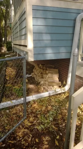

Talking to the neighbors they suggested a ask for forgiveness later approach. So went ahead and moved a little of the wood to see if anyone complains. Not perfectly ideal from what I read, but much better than before.

Maybe stack it the other way so the air can flow through the stack/stacks a bit better.
