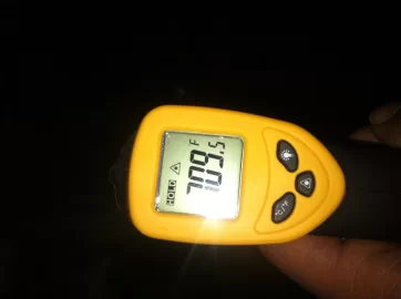

That is what mine looked like about a few hours ago The front of the stove was 650.
