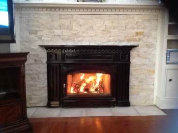

I'm not sure why you wouldn't consider VC. I have the VC monte and just love it, purchased in Aug 2013. The large viewing glass with the Georgian surround is awesome looking. The heat output is decent for a smaller stove, provided using dry wood, as is with any other EPA stove. The dealer I purchased from told me it was a good stove, and when I told him of reading some bad reviews on the stove, he said he hadn't heard of any complaints from previous sales of this unit. Also, the installer said he had installed 60-70 of the VC monte, and had heard of no complaints either. So I'm not sure of problems with this stove, other than some of the complaints on this site. This is my first year with this stove and have been using pretty much everyday when home, and all weekend. So time will tell how it will fare, but so far no complaints.

I agree completely, you can have a nice cozy room like this if you got th VC monte.......
