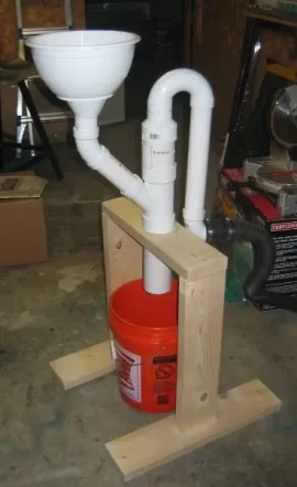

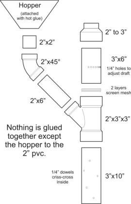

I also use a vac system like kap does. I’ll attach some photos. Wife complained about the dust, and I didn’t want my auger and what not to clog up over the years so I figured what the heck. My procedure is this: I have a large trash can on wheels with a flip cover (Rubbermaid) that I keep filled with my vacuumed pellets so the wife and I just scoop out of that and bring them in the house when needed. I just spend about 10 minutes every Saturday filling that container with vacuumed pellets so there are always some on hand. Not much work really and it makes a significant difference on the dust level in the house.
