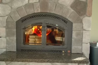

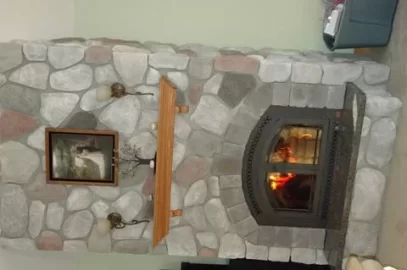

I attached a couple of pictures of our FX. You can probably notice I still have a little touchup work left but for the most part it's finished. Sorry about the crooked pictures. I had a 5 year old "helping" me.

Dear youngstr,
Thanks for the photos. It's good to know about the location of the fan, too. I think you and the 5 year old did a fine job of framing the photos.

Nice work Y. The installation and FP looks extraordinary.
Thanks for the positive feedback everyone. Although I did the stone/finish/framing work I was glad the experts set the unit and installed the chimney. I felt(and still feel) their expertise was worth it for the most critical stage of the installation.

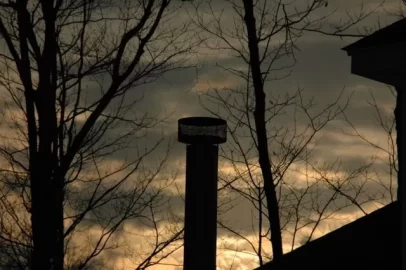

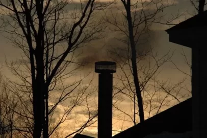

Actually the converter is easy to get going. Unfotunately I have a lot of pine on my property which burns fast and hot. I guess in this case it works to my advantage since it warms the unit up quickly and gets the fireplace to the point where I can engage the converter. I'll admit going into this whole thing I was a little skeptical about how the catalytic converter would work. But when the converter lights up it's truly amazing how much extra heat the fireplace puts out. I also find myself running outside once in a while to see very little smoke coming out of my chimney.
I'll have to see if I have any pictures a few minutes apart showing the catalytic converter engaged/disengaged.....It's very cool to see.

OK everyone. I took a couple pictures tonight with the catalytic converter engaged and disengaged. The pictures were all taken within 5 minutes of eachother....
Here's with the converter disengaged;

Here is a couple minutes later with the converter engaged. I'm afraid the pictures don't really do it justice......I wish I could post BTU output from the fireplace with the converter engaged/disengaged....
Y
