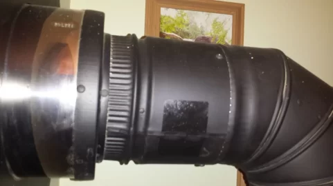

This is the adjustable length attaching to the stove pipe adaptor that connects my class A. You can see the finishing band barely covers the crimp. I could probably hammer in on further with a dead blow hammer, but I shouldn't have to do that.

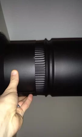

This is my selkirk double wall where it attaches to the stainless.
Sounds similar to what you speak of. All other connections seated the entire length of the crimp but this one is maxed out how you see it.
Works fine and the screws prevent any separation.
