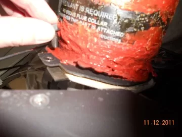

Well just a update I have been in contact with Selkirk, and there trying to help. I got a email from them telling me that my pictures look like my tee cap is in wrong. I explained to her it was in proper, the chimmney company even looked at and said it was in proper. I even showed her links here where folks here have had the same problem as me. I ran it in the dark and checked with a flashlight to see if I can see smoke and I see nothing now. The problem is its giving me a headache, and If you smell where the air comes out from the blower there is no smell on the right side, but a smoke smell on the left. I think there is a leak still some where and the blower is picking it up and blowing it out the front. Im about ready to pull my hair out, we have a frost warning tonight and I would love to be using it.
Maybe try looking inside the stove.....
A few M-55 owners had problems like this at the beginning of this season. It ended up Not being in the venting at all.
It was the the exhaust collar of the stove (where the stove adapter/1st piece of vent) where it connects to the actual blower housing. IIRC, someone had to even double up on the gasket that goes in there. The way its secured seemed pretty shoddy.
But this area is near where the convection blower can pick it up (within the stoves shell).
Brokenwing, did you ever post pictures somewhere else of the exhaust pipe setup? specifically the tee? the tee cap?
And Dexter is correct about the M55 exhaust starter tube connection can lack tightness on one side of the connection. You can kind of visually check it by looking at the white gasket in between the exhaust starter tube and the motor housing. There is one screw on the upper right corner and two metal tabs folded over the other side of the starter tube. The gasket material on the metal tab end will look thick, thicker than the material on the other end where the screw is. If the exhaust pipe is disconnected, you can also pull on the starter tube and see if it wiggles a little on the metal tab end.

I can post some pictures vinny. I bleieve this is where the problem might be. Im going to put some more silicone around the flange of the combustion blower. I will post some pics of the setup for you. I think I have the pipe sealed, Im not seeing any smoke or embers from the pipe anymore. Anyway here is some pics of the setup. Thanks Vinny, Dexter, and everyone else that has replied thus far, Im so stressed and all help is appreciated.

From here it looks okay. I don't see silicone in the space between the inner and outer pipe of the stove adapter. That could be the culprit. If there is a leak anywhere in the pipe, smoke will find its way out that space. If you are going to take it off, it is best to put a thick bead of silicone there.

Ya its hard to believe but before we siliconed it up you could see embers coming out of the tee. I have the ember problem taken care of now im just chasing a smoke smell. Im not planning on taking the pipe off I have so much sealent on that thing its not even funny. I took the stove panel off on the left side of the stove near the combustion blower per your post. I found some areas of silicone that look like it could of been missing. I siliconed the heck out of that, and If it cools down one evening I will fire it off and see If i have the problem solved. Im still working with Selkirk I think there going to send me some new parts. I thought this would be easy, buy the stove, install it, and done. boy was I wrong lol.
Hate to say it, but you will have to disconnect the stove from the exhaust pipe for maintenance at some point. Removing all that silicone will not be easy or fun. Make sure you get it to work without all the extra silicone, or at least device one connection point that is easy to take apart for future maintenance.
The exhaust starter tube and folded-metal tab connection is supposed to be that connection, and you should be able to disconnect that one bolt and slide it over to disconnect.

Yup. I would recommend sealing up that secondary space at the adaptor. Thats what I did and have no more smell.
Well the way I have it I can still unhook the stove pretty easily. You only need to change the gasket on the combustion blower bi anuanaly correct. I will seal around the secondary adapter space, and see what happens. Were suppose to have a drop in temps next week so we will test it out and report back.
