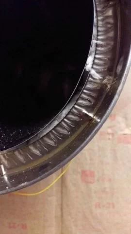

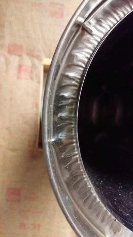

I bought all new Selkirk sure temp for my boiler install , and thru wall kit . Of course I just installed it all before noticing this , but there is a pretty big gap on all my pipes on the ends so when u connect all the pipe and look up the chimney at each connection u can see it sticks in the pipe quite noticeably. I think cleaning it would be a pain with a brush , and not to mention the insulation is exposed to the heat and fire . Can anyone tell me if this is normal or not ?
One photo the pipe is close to the outside like I believe it all should be , then the other photo in the bottom right corner of the inside of the pipe u see the gap I'm talking about . I don't think it should be like this .

I think I would ask wherever you got it from. Or email Selkirk the pics & ask them. Doesn't exactly look right in those epics, to me.
Much appreciated , I emailed them pictures and a description this morning , I'm hoping they get back to me sometime today , it sure doesn't look right to me I know that , and I don't have that warm and fuzzy feeling about it now

I just spoke with Jeff from Selkirk technical support , he saw the photos and said its fine and its OK to use and nothing's wrong with it
I'm not sure I buy that - seems to me you shouldn't be looking at the insulation layer on the inside of the pipe - that's a direct path for exhaust to hit.
Did you buy it local? I would take a piece back & show it to them & look at others they have to see what they look like - just doesn't seem right. Too bad more feedback wasn't coming here - must be others out there with this stuff? I put my own stainless chimney up 20 years ago. I don't think it was Selkirk (was a GSW product) - but no way did it have gaps like that.
Trust me I don't feel all warm and fuzzy about this. I'm going to go back to the store and open a few boxes and see what those pieces look like , if they are all like this then OK , worst case scenario I have a documented case and it's got a warranty

I contacted Selkirk again , I asked for another email to send pictures to , they just got back to me and said gaps between the end plate and the pipe like that are perfectly fine .

No smooth fit , the inner pipe extended inside about 3/8" , I've called and talked multiple times to Selkirk and even emailed them pictures , the newest response was .............""""Below is response from Tech:
These systems only work when they have an internal pressure below atmospheric pressure. That creates a vacuum inside of the chimney pipe. Air would leak into the chimney pipe not smoke leaking out. There is no issue with creosote building up at the joints.

By the way , when I was in lowes tonight I opened a box of the Selkirk supervent and it looked like mine . I know I have the Selkirk sure temp , but wanted to see if it had same gaps on the end of the pipe , and insulation showing , so I'll just use it and if I have a problem I have a warranty and emails I printed off as proof I thought there was a problem in the first place
